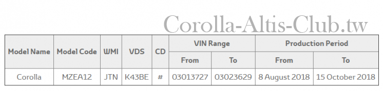

Q2. How many vehicles are involved?
多少數量?
A2. Approximately 2,640 Toyota vehicles are involved in Australia. See the table below.
澳洲大約有2640台
Q3. What was the production period of the involved vehicles?
什麼時候生產的?
A3. The involved vehicles were produced between August 2018 and October 2018.
2018年8月~2018年9月
